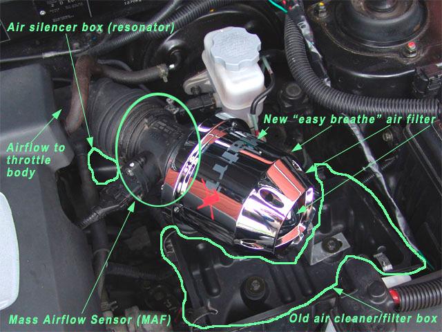

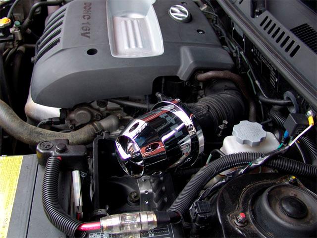

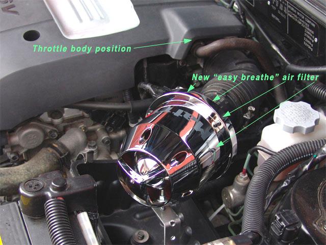

What I did was I removed the air hose between the air filter/cleaner box and the MAF (mass airflow sensor), and
installed the easy breathe sport filter directly on the MAF. The new filter has a heat shield, a poor one, but it's still
much better than the original air intake idea.

The air silencer, located between the MAF and the Throttle Body (under the air hose), is a major air intake killer
and a power sucking bad bad part
It is there to remove air intake sounds, but will make the air bounce like crazy. This is very bad, and the air
silencer box MUST be removed to be able to feed the engine with the undisturbed air flow it must get. This
is not a joke, and I will soon remove it myself (I'll get some pictures up when I'm done with it). Also, since the
new air filter is making a COOL noice, why use an air silencer that cannot remove the sound?

NOTE:
These pictures are taken with the old air filter box still in place, I will remove it later on and make a better
and nicer installation of the new fantastic air filter.
