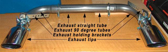

Here's the parts of the exhaust system on the Santa Fe 2.4 4WD
1. Exhaust manifold
2. Catalytic converter
3. Small muffler
4. Pipe to the back of the car
5. Main muffler
6. Exhaust tip
The above route is the correct way for the exhaust system of the Santa-Fe 2.4 4WD.

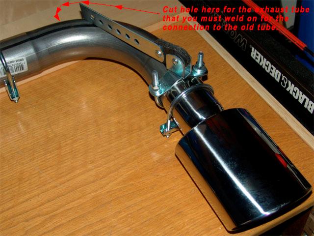

1. Build the exhaust tips with exhaust tubing and exhaust tips (as seen on pictures below)
2. Cut holes in the rear plastic fender where the exhaust tips will exit (you will see where to cut, trust1 me)
3. Cut tube right before the rear muffler and remove the muffler
4. Make a hole in the exhaust tip tubing on the right back side (seen from behind) and weld on a piece of tubing
5. Install the whole rear tubing with exhaust tips
6. Connect the exhaust tube (that was connected to the muffler) with the tube you welded on to the tip-section.
