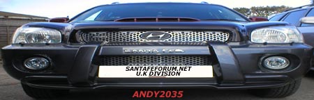

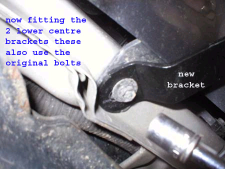

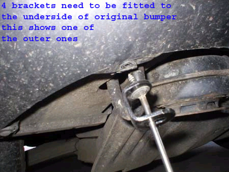

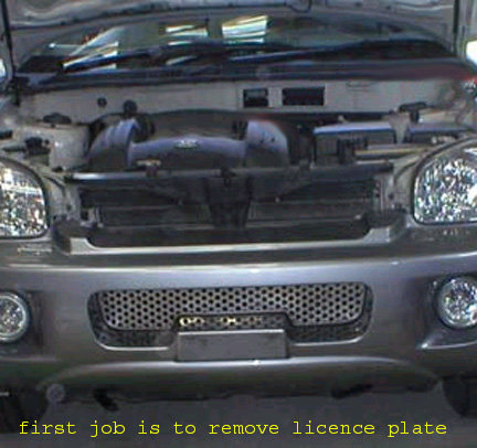

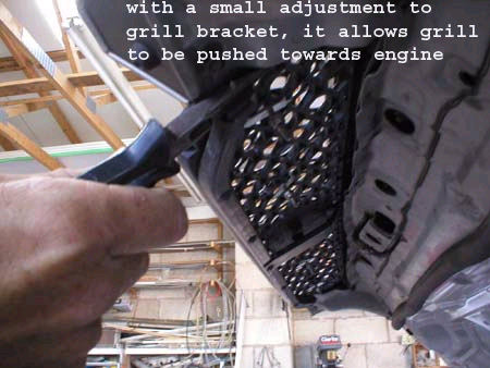

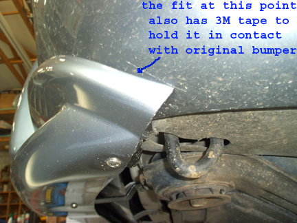

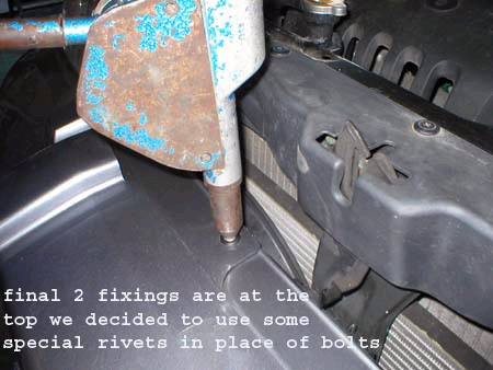

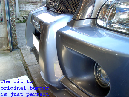

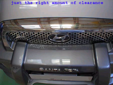

The sport bumper is,in my opinion a very smart
addition to the standard Santa Fe bumper, both I and
Andy decided to have this mod done to our Santys.
Hope you enjoy the info....

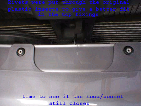

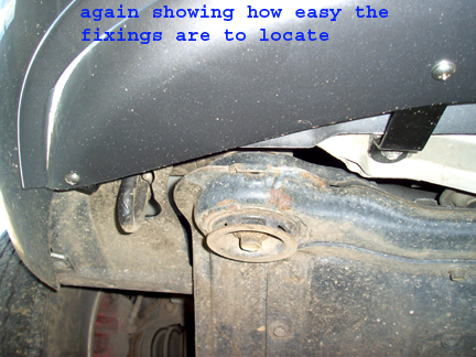

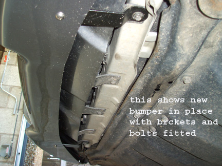

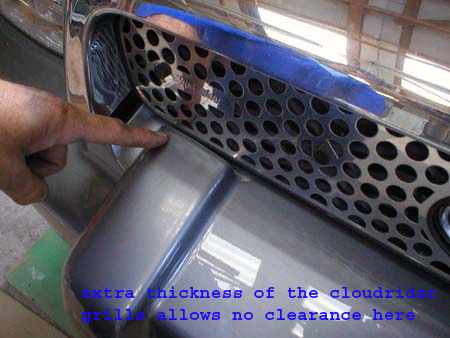

Partguy who supplied this item suggested to use zipties
at the 2 lower outer edge brackets because as we found it
was difficult to locate the 2 outer bolts.

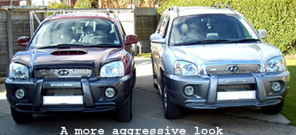

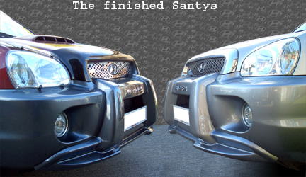

As the pic says, we think it gives the front end of the
Santy a far more aggressive look.
Time to fit the first one was about an hour, second one
just around 20 minutes, also worth noting is that this
part can be moved to your next Santa Fe without causing
any damage.
Our thanks go to Partguy who went to great lengths to ship
them out to the UK in record time, and he gave us a great
deal.

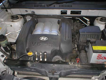

H.D's engine bay...: -

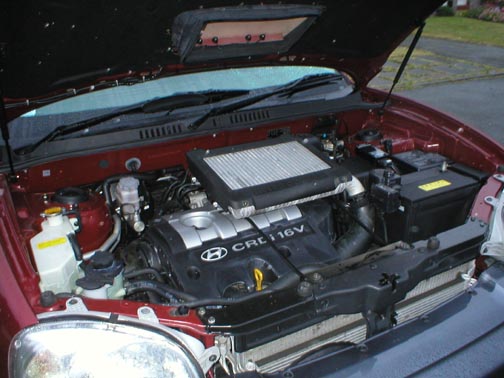

My engine bay...: -

Boy does the Sports Grill look great on my wife's
White GLS, 4WD, 2004
Great show and tell guys!!
I also picked up a Sports Grill from Partsguy!
It was really dificult to get those top two bolts in; [i]rivets[/i]
what a great idea!
Thanks for the tip about the nylon cable ties! I was
wondering how I was going to get the two end bolts on
the bottom secured.

I was having a problem getting the two ends bolts on
the bottom of the grill to go in, and was ready to try
the nylon cable ties as suggested, and then I saw the
pics on installing and figured if two English guys
could get it right so could I!
Went back and gave it another try and now the grill is
bolted up solid!
